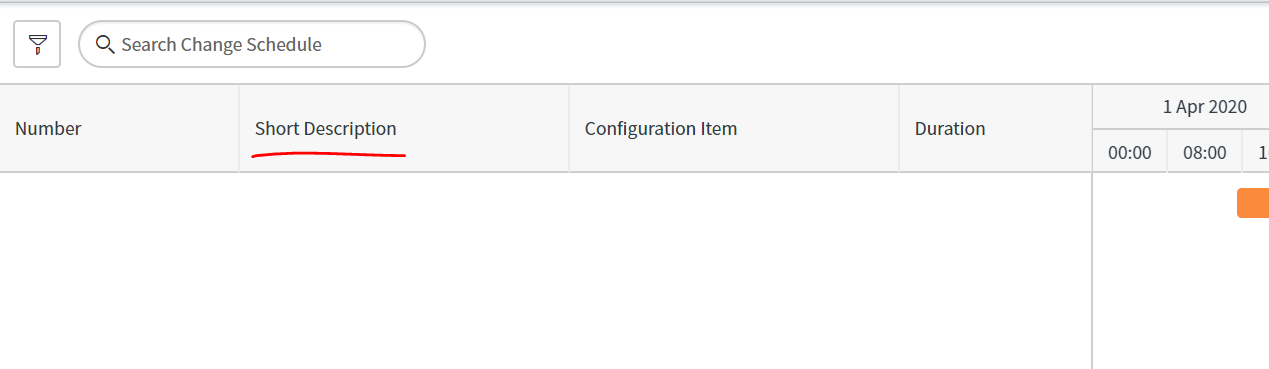

I am trying to include short description field. And for that I have modified the below listed UI scripts however still value is showing as undefined for short description.
1) sn_chg_soc.change_soc :- 6ff41e3ac31303009f93dfdc64d3aebb
2) sn_chg_soc.config :- e3d75abd573703009f9379a18d94f973
3) sn_chg_soc.data :- f427288e57b703009f9379a18d94f911
Any help will be much appreciated!!!

Hi Sree,
Thanks for your response.
I think you have misunderstood actually I would like to include short description column on the left hand side of the change schedule next to number. If you already meant that then sorry I tried it but still no luck. Do you like me to share the changes, which I did on all UI scripts?
