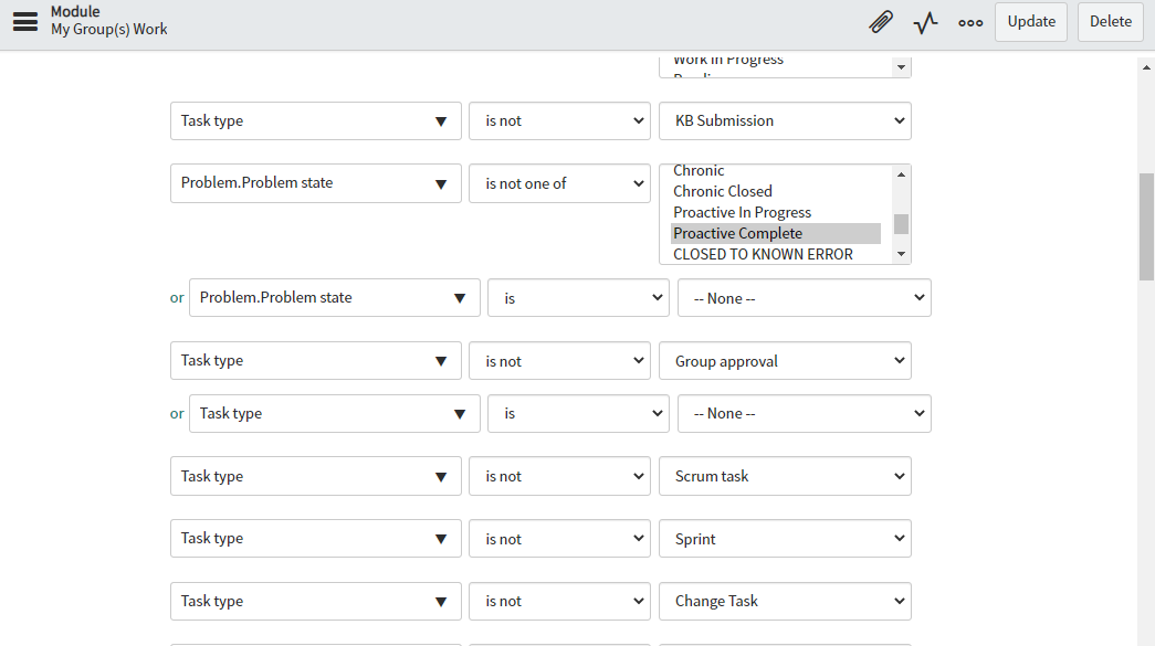

I need to add condition in the filter that Problems with Proactive state should not show when a user clicks on My Groups(S) work module.
‎07-12-2022 01:32 AM
If this is the OOB menu item as below, select the edit module pencil icon to modify the filter
You can then apply a filter by dot walking to the problem table fields, and selecting the field you want. "Proactive" is not an OOB state, so sounds like a possible customisation

Hi Bharath,
You can edit the module condition by clicking on the pencil icon on the module in the application navigator.
