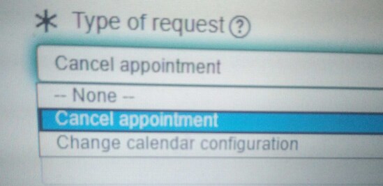

I have select box variable on catalog form, when the user choose any of the option, Help Text or Information (i) should pop up or occur.
When "Cancel appointment" is highlighted, "To cancel your appointment scheduled for site pick visit on scheduling tool" should show up
When "Change Calendar configuration" is highlighted, "To request changing calendar configuration of the scheduling tool".
Please help me out, how to achieve this.

You can use the g_form.showFieldMsg() that shows up on selection. You need to create an onChange() client script that runs when the field above changes. You can then compare the value & display required message below the field.
Showing it in 'i' option is not possible as it is purpose is to show referenced records & not information.

‎06-26-2020 01:50 PM
return;
if(type_of_request == 1)
g_form.showFieldMsg('To cancel your appointment scheduled for site pick visit on scheduling tool.');
else if(type_of_request == 2)
g_form.showFieldMsg('To request changing calendar configuration of the scheduling tool.');
I made use of above script, but nothing showing up
‎06-26-2020 02:05 PM
return;
var val = newValue;
if(val == 1)
g_form.showFieldMsg('type_of_request','To cancel your appointment scheduled for site pick visit on scheduling tool.','info','true');
else if(val == 2)
g_form.showFieldMsg('type_of_request','To request changing calendar configuration of the scheduling tool.','info','true');
Working fine.
