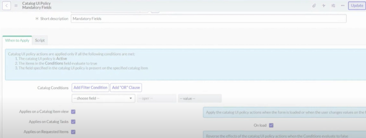

02-03-2024 11:11 PM - edited 02-03-2024 11:13 PM
Hi @nikhitha24 ,
1. Open the catalog item.
2. Create a new catalog UI poilcy from realted list of catalog item.
You can create a catalog UI Policy were you have 3 check box called .
1. Applies to catalog item view
2. Applies to catalog task (check this box)
3. Applies to requestred Item.
Apply necessary condition and save... I hope this helps...
