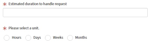

I need to convert integer value into Duration format and capture it in a Field whose type is also Duration.
Scenario :
I have a catalog form, which has the below variables :-
If any value is provided, in the 1st variable and the unit is selected, accordingly, we need to convert the value into a duration type (DD : HH : MM : SS) and return the same duration to another field placed out on sc_cat_item table.
Any leads, how we can get this done will be really helpful.
Angshuman
