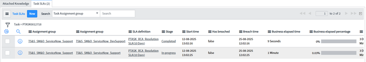

I have created a new "Resolution" SLA on PTASK (problem_task) table, that should run a new SLA, everytime the Assignment group changes.
But the issue is, whenever an Assignment group is filled, a new SLA is being triggered, and however, when again changed, it is overriding the previous SLA and the group name is getting changed to the new one. So, both the new SLAs are getting attached to 2nd Assignment group.
Please help. I am very much confused.
But you can see below, I had changed the group
But both the SLAs shows the new group name. How is this possible? Where is the SLA for the 1st group? You can see, it has overridden it and shows the 2nd group name as Completed. Please help.

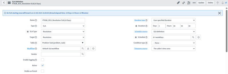

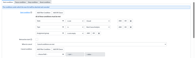

My SLA which I created:
My requirement is that, for every group change, there should be a unique SLA attached to that particular group, either Completed or In Progress.

Dr Atul G- LNG
Hi @AbdurRahmanSnow
That is the expected behavior because the system checks as soon as the group is changed and attached. The system is not intelligent enough to determine what the previous group was in this case.
Try adding this condition.
Also, whenever we want to attach an SLA at the group level, it is actually an OLA, not an SLA. In ServiceNow, there is no implementation difference between OLA and SLA — only the type changes.
Try the above condition alone or in combination with your condition.

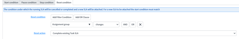

Pradeep Thipani
Hi @AbdurRahmanSnow ,
 Remove the reset condition of that SLA and verify, because in reset condition when you give assignment group changes whenever the group changes it will override existing and add new group SLA.
Pradeep

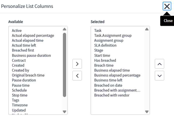

AbdurRahmanSnow
Hi everyone
Got the issue.
There were 2 Assignment group columns, which was causing the issue. I just dragged the other Assignment group column and it is showing the other group.
