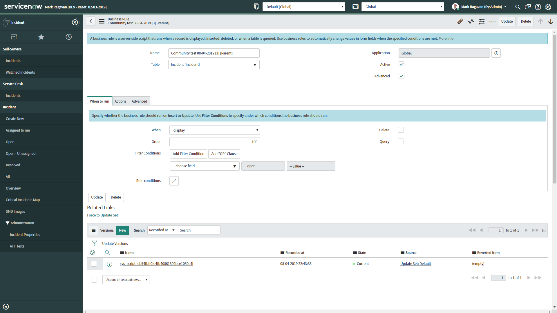

Hi there,
See the screenshots below! Tested this on my personal developer instance, works instantly.

Hi there,
Theoretically, you could also just check the parent field. So instead parent_incident, just use parent. Do check your data, check what the value is on the parent field for all your incidents. I'm mentioning this, because theoretically, you could also have other tickets als parent, not just incidents.
If in your case, only incidents: just go for the parent field. Parent is also available on incident (because it's extended), so no tricks needed. Just replace parent_incident in the BR suggested, with parent.

Thanks Mark, I was being a spanner and forgot that was the case!
Works a treat, many thanks for your help.
