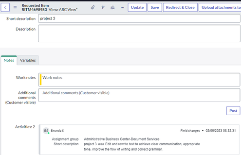

But when i create request , given short description as 'Test' for RITM , sometimes i see default short description RITM and somtimes as 'Test' its not constant in notification
Pls refer the below img.
Here in RITM form default text is overridden by 'TEST '
but in email notification its giving default one

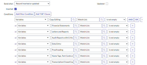

Below is the triggering condition for notification
can i use gs.sleep() in email script as below, will this solve my issue ?

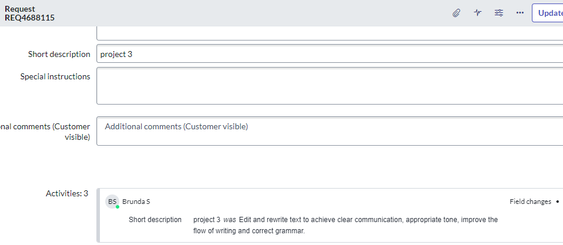

I just know that RITM Short description default text is copied by REQ not sure which script is manipulating , whoever when user enters short descript from portal , it is updates on RITM form as well as REQ from.
but the issue is when notification is received with current.short_description , the value is flicker sometimes i get default text itself and sometimes the short description entered by end user. but i need the short desc enter by user in notification.
