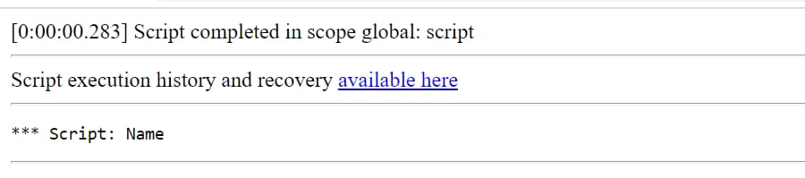

ā08-12-2022 11:45 AM
Here is the simple way
var str="Name|Email";
var name = str.split("|")[0].toString();
gs.print(name);
Mark the comment as a correct answer and also helpful if this helps to solve the problem.
