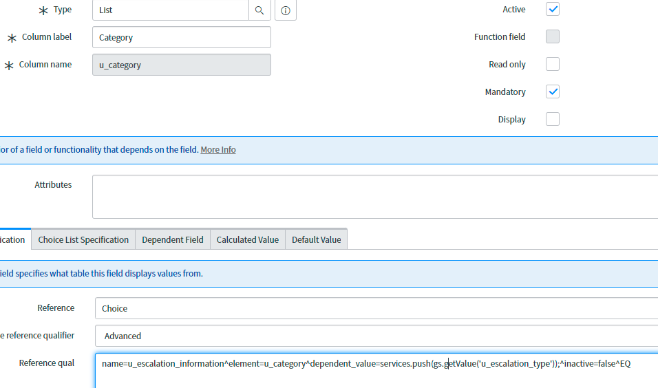

I need to populate list field ( field name- category) dynamically, based on selected value on  drop down( field name - type), I have wrote the following reference qualifier. But the issue is I need to get the selected value to u)type field dynamicaly.
That means let's say type field has two values A,B.
If type is A,
then category should be A1,A2,A3
If type is B,
then category should be B1,B2,B3
So, according to the above query when I select type A, and select category, nothing is populating
how can I modify this query to take the dynamic value of type field and filter.
Any suggestion is highly appreciated!
