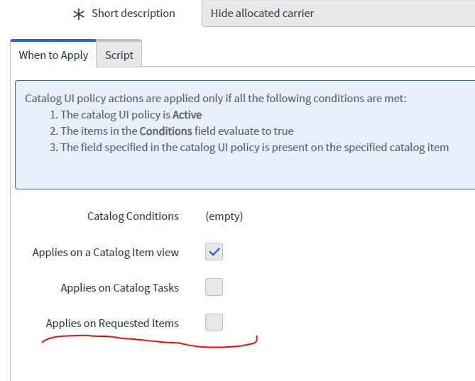

You can create this with a catalog UI Policy and then check this checkbox to make it run on the RITM as well:

02-20-2019 11:49 AM
Thank you It worked!
