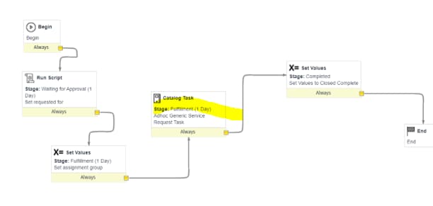

Workflow is simple as attached.

looking at your workflow, once RITM is approved it generated a catalog task and once it completes , RITM will be closed.
you configure a simple BR as below (however this is the ideal solution since your not ready to use other flags on RITM)
Refer the below link to add stages to your workflow
https://docs.servicenow.com/bundle/paris-servicenow-platform/page/administer/using-workflows/task/t_...

As per your suggestion I have configured the BR, however it is not working. So I think you are saying in addition to the BR I should also modify the workflow for this to work.
Can you please guide on which core activity I should add to my existing workflow for this to happen.
