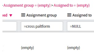

Assignment group field is updated in background script (PFB) , but value is not displaying in form as well as in list view. But if I tried to update assigned to field using similar script(d.assigned_to='XXXX') it works fine. I can use setDisplayValue() in below script to make it work for group, but I just need to know why assigned to filed got updated correctly and not group field? what is the difference between these fields referencing to user/group table? Note: Even I checked both dictionary override fields, there is no much difference. Also, no field in user/group table is marked as display true and value we are trying to update in group field is available in instance.

It mean you are trying to set a value to reference field which is invalid.

The difference is than any reference field will take sys_id if you are setting the value directly.
setDisplayValue works fine when you provide correct display value.
the line which you have written in code:
d.assignment_group='cross platform';
will never work, because this format needs sys_id and not display value
d.assignment_group='sys_id of the group';
