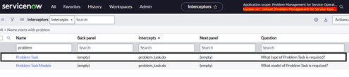

Hello @Debasis Pati ,
For Native UI you can navigate to :
System Definition > Interceptors :
For Workspace popup window you can navigate to :
Application navigator > "sn_sow_interceptor_record_type_selector" :
This will remove the Root Cause Analysis option !!
