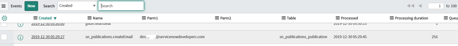

Hi Asif,
This below one is triggered.
Rest of the recipients emails are not triggered.
Logs are not triggered.
Hello Sai,
You need to fetch the recipients and add them to the event queue or select the recipients under Who to recieve section in user/fields.
There is already an inbuilt API Recipient List api which is doing this job and triggering the event. Any reason why you are creating separate event and code?
