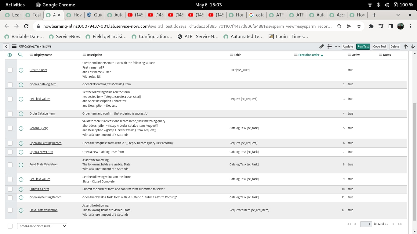

I have created catalog item and also workflow is attached to create catalog task but after that i want to closed catlaog task state to closed complete and also validate RITM is also complete or not.
Below are the steps which i created. I do now it will not produce me to expected result please help me for getting result.

you need to get the catalog task first for the REQ and then close it
Till where it is working fine?

in step 5 you should check and find REQ
REQ [IS] Output from Step 4
‎05-06-2022 04:42 AM
ok fine i will change step 5 and rest all the steps are right or also they need any changes
