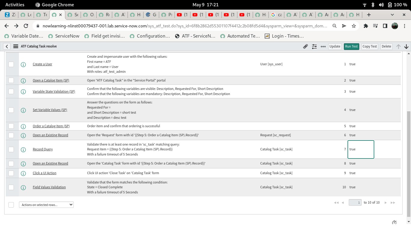

I have created catalog item and also workflow is attached to create catalog task but after that i want to closed catlaog task state to closed complete and also validate RITM is also complete or not.
Below are the steps which i created. I do now it will not produce me to expected result please help me for getting result.

you want to open sc_task then why to open sc_request at step 6

So where are you stuck now?
you can open an existing record for sc_task using condition for RITM
Then click the UI action for closing the task
