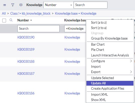

I think you can use this script;
var gr = new GlideRecord("kb_knowledge");
gr.addQuery("kb_knowledge_base","old_knowledge_base_sys_id");
gr.query();
while(gr.next()){
gr.setValue("kb_knowledge_base=<new_knowledge_base_sys_id");
gr.update();
Or you can set from knowledge articles list via update all option.
