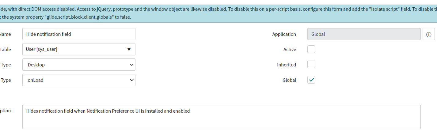

If you are doing it on the User table there is already a field called Notification
So, if you just enable or disable it based on that the allow notification on preference will also automatically change
If you do not see the field on the User form just make the below client script on user table as false
