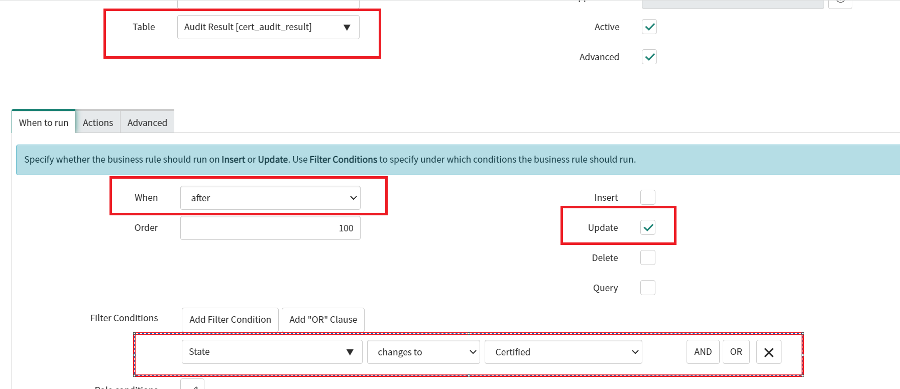

Hi @Sachin Gavhane
Please write a After Update Business Rule on the Table "Audit Results(cert_audit_result)" and use the script below:
BR Details:
Table Name : Audit Results(cert_audit_result)
When: After Update
Condition: State Changes to Certified
Script:
	// Add your code here
	var getCI = current.id;
	var gettargetTable = current.table;
	var gr = new GlideRecord(gettargetTable);
	gr.addQuery('sys_id',getCI);
	gr.query();
	if(gr.next()){
		gr.FIELD_NAME = 'certified'; // Please make sure to replace "certified" with its correct back end value here and and also replace "FieldName" with the correct field name which you want to set.
		gr.update();
})(current, previous);
This is working for me in my PDI.

Hi Shloke,
will this work if there are two CIs in one record of certifying elements?
In above row there are two CIs , Business Application : kofax total agility  and Name (Application service): kofax total agility (production), for both these CIs the custom field should have value "Certified", so will above business rule will work for both the CIs?
@Sachin Gavhane
Yes it will work for any number of CI which are getting certified.
You just need to set up the Business Rule exactly similar to the way I have mentioned.
Shloke
