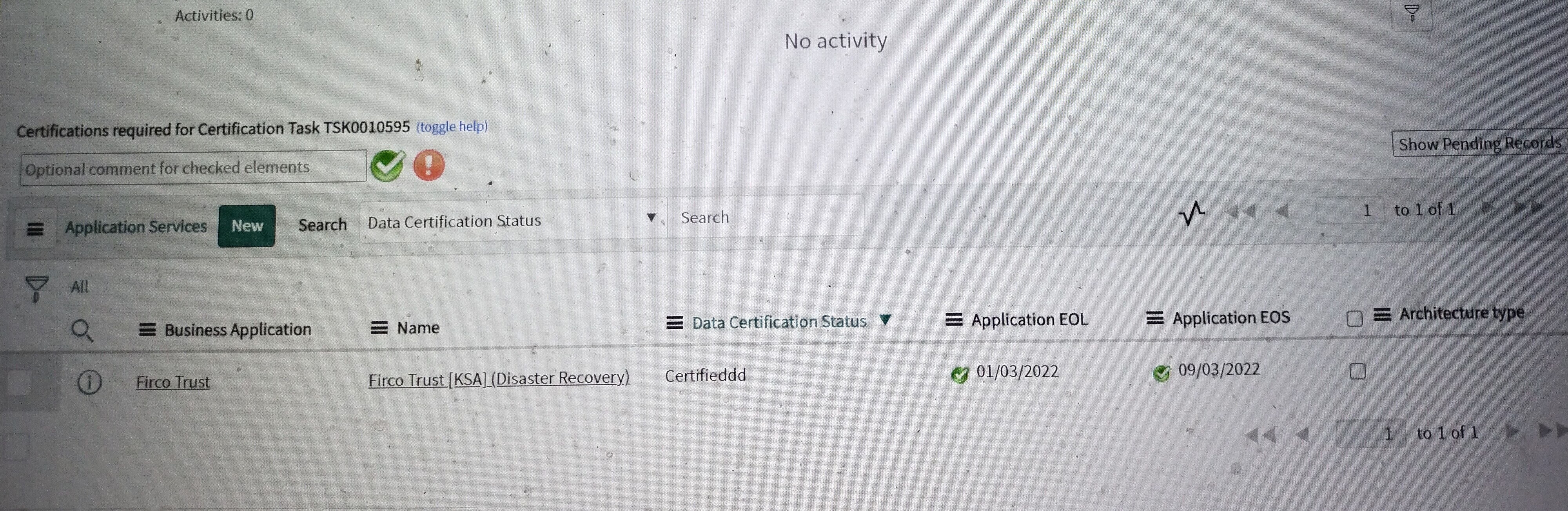

‎03-02-2022 08:52 PM
Currently , if i certify any one element also, still the value of the custom field "datacertificationstatus" becomes 'certified' for that respective CIs.
but i want -- in particular row if I certify all the elements then only the respective CIs of that particular row should update the value of custom field "datacertificationstatus" to 'certified'
example: In the attached image, there are three elements to get certified in a single row,
application eol
application eos
architecture type
so for CI with the name (business application)Firco Trust, the value of the custom field "datacertificationstatus" should be certified only if all the three elements are certified, means all the elements in a single row should be certified then only custom field will get value as 'certified'
