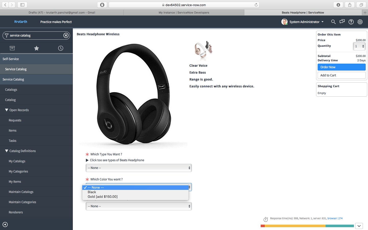

In service catalog i want to change color of my image whenever i select different color from select box , so i need output image is same as i select color.
krutarth0023
find_real_file.pngin this image,  i want id i select gold color so gold color headphone comes up. so is it possible ?
