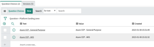

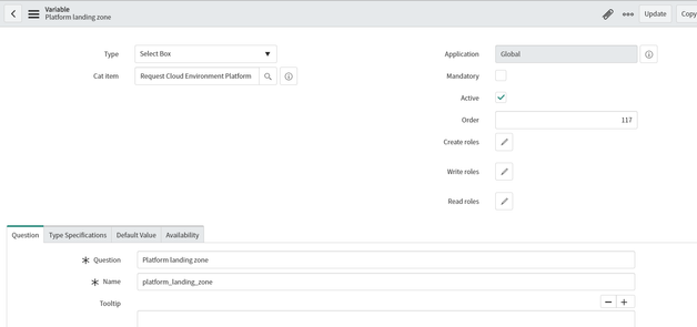

can you share variable configuration screenshot?
It's a select box variable right?
Hi Ankur,
Thanks for your reply. Yes, this variable is Select Box and have 2 choices.
