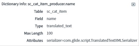

03-18-2016 08:06 AM
When I move this to production, management wants to know it was done.
As a test in my demo environment, I disabled a catalog item with a class of catalog item and that fired off a notification. So, it has something to do with the fact that this is a record producer - which appears to be on a different table.
03-18-2016 08:14 AM
Fixed it!
Changed the table from Catalog Item to Record Producer. I also added a name, so that it only triggers on this particular one.
