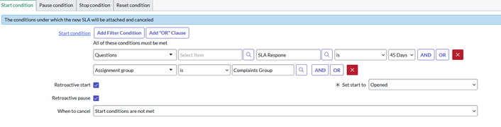

I have created an incident form with some custom variables, and have mapped one of the custom vars to update the impact variable with an onChange CCSript.
Then there is a new response SLA that is triggered for this incident form.
So far so good.
Now what I need to achieve is have the SLA definition change base on that custom variable.
eg.
Custom variable is response and has 3 options 14, 19, 45.
CCSript sets impact to 1 for option 14, 2 for 19 and 3 for 45.
By default the response is set to 45 and is read only for non fulfillers.
The first time the script runs that is with the submission of the inc and the SLA 45 is triggered and attached on the said inc.
Afterwards, I change the response var to 19, fill in a worknote (it is mandatory) and hit save. The impact var doesn't change and the SLA 45 def does not get cancelled. Obviously as a result the SLA 19 does not get attached on the inc.
Attached the CCSript.
Any thoughts?

Hello, I managed to change the SLA depending on a question that was on the form of the incident.
So case closed!
