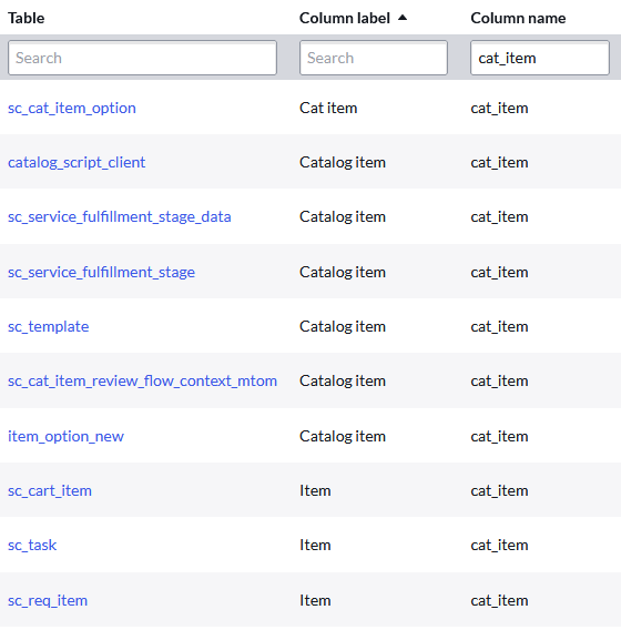

You will know it directly by the table your business rule is defined for, but I can make a guess what the table is as i can see it has a field cat_item. So it must be one of the following 10 tables (considering just out-of-the-box tables including this field):
You can get this result via: https://<your instance>.service-now.com/sys_dictionary_list.do sysparm_query=elementSTARTSWITHcat_item&sysparm_view=

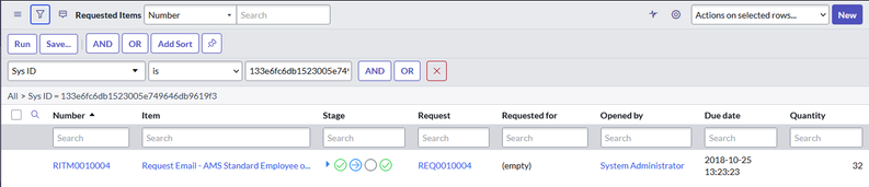

Let's assume it's sc_req_item (the table Requested Item). Then you can get your wanted object by simply searching Requested Item with the given sys_id via using a standard filter on the respective list view, like this:
If your table is different, then the method will be the same.
a little trick: You can even use a shortcut, once knowing how the ServiceNow URL works:
https://your_instance_name.service-now.com/sc_req_item.do?sys_id=133e6fc6db1523005e749646db9619f3
just copy the URL and replace the sc_req_item with another table name, e.g., sc_task, the sys id will stay.
https://your_instance_name.service-now.com/another_table_name.do?sys_id=your_sys_id
