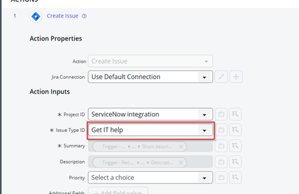

I’m working on a bi-directional integration between JIRA and ServiceNow.
I have successfully created the Credentials and Connections. However, when I create a flow in my Office instance, the Project ID is populated, but the Issue Type ID is not appearing.
Interestingly, using the same credentials, the Issue Type ID is populated correctly in my PDI.
Could you please help me understand what might be causing this difference?
Thanks in advance for your support!
Office DEV Instance :
My PDI Instance :
Ashok
12-04-2025 10:44 PM
Hi @B Ashok
Are both instances on the same patch version and the same plugin version?
12-04-2025 11:00 PM
All Same, same patch, same plugin version.
12-04-2025 11:04 PM
Your Office instance can authenticate using the credentials, but the follow-up call to retrieve Issue Types is blocked bcoz Production/office instances often sit behind corporate firewalls, proxy rules....
OR
Use the Jira REST API manually:
GET /rest/api/3/issue/createmeta?projectIds=<yourProjectID>
If it returns no issueTypes, that is the cause.
12-04-2025 11:11 PM
did you compare the "Create Issue" flow action in both the instances?
seems the Issue Type ID is dependent on Project ID and it will be brought in based on Project ID in Jira
check link below
Jira Spoke - Not properly pulling Project Key, Issue Type and Priority
