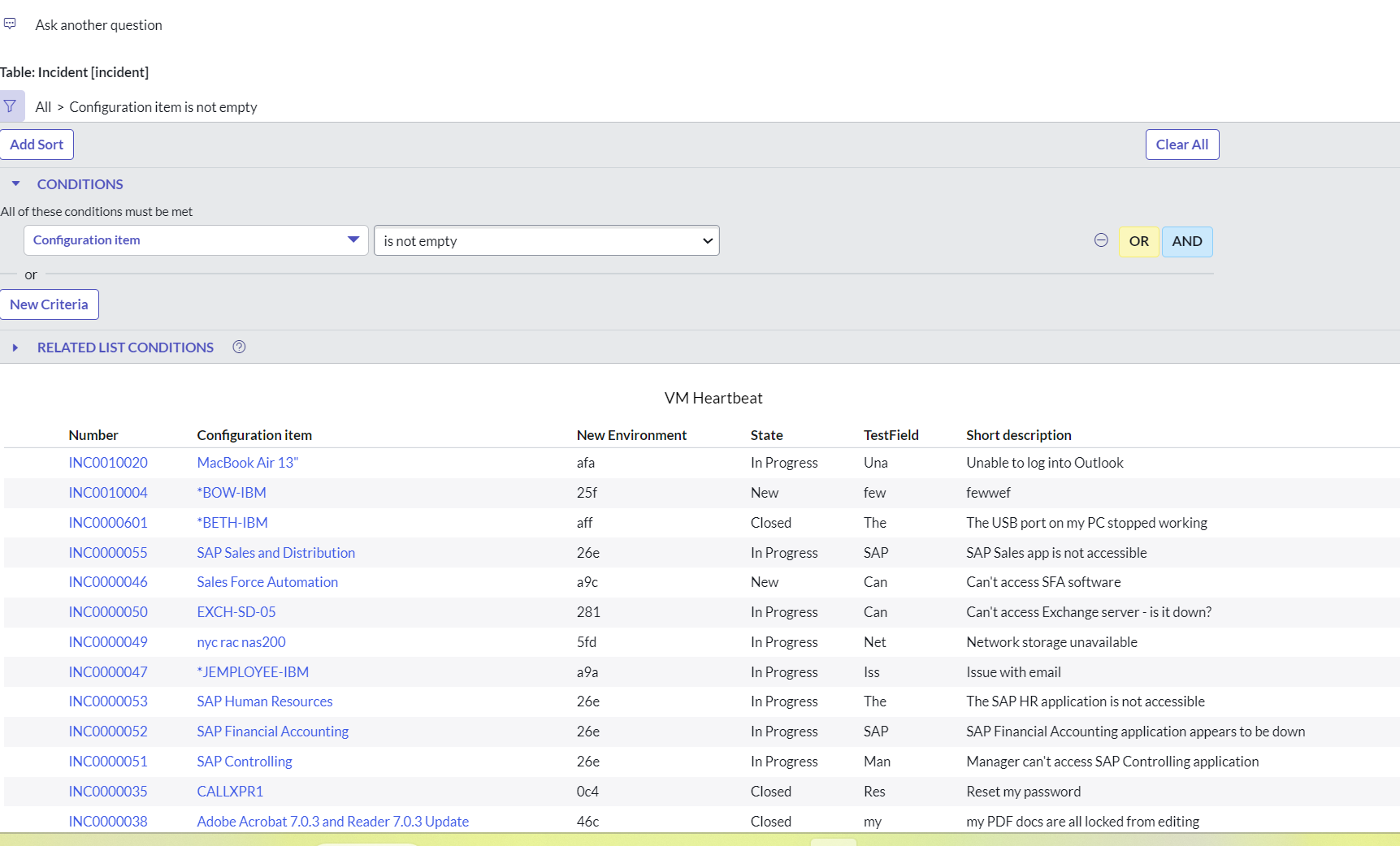

I am trying to create a new report where I need a new field called 'New Environment'.  This needs the first 3 characters from the Configuration Item field.
I have used the 'Configure Function Field' using:
glidefunction:substring(cmdb_ci,'1', '3') However I am not receiving correct result, it displays some jumbled text.
However, if I use this function to display the first 3 characters of the 'Short Description' field, it works fine and displays the characters.
glidefunction:substring(short_description,'1','3')
