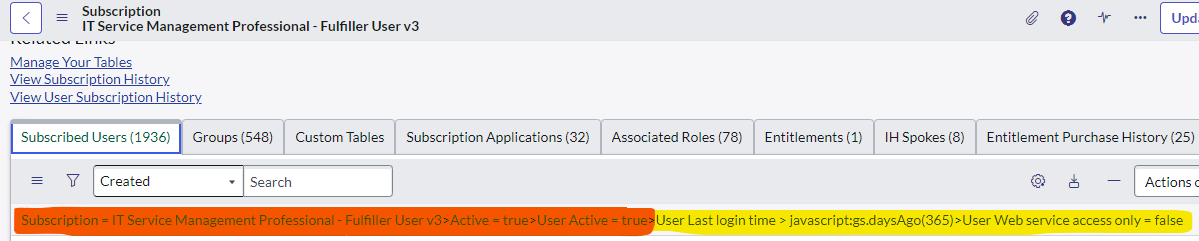

In the 'subscription overview' dashboard, the ITSM fulfiller license is not showing the correct result.
It is showing all the users of the groups which are added in the subscription 'IT Service Management Professional - Fulfiller User' but as per the ServiceNow documentation, they do not consider the users who didn't logged in, in the last 1 year and user accounts for which web services access only is true. But the dashboard is not excluding those numbers.
The 'Update allocation tool' button on the dasboard is not considering those filter. Could anyone please guide where is those conditions defined so that we could modify that and reflect the correct number? Thanks

Hi Mark, thanks for responding.
Our Instance is on the vancouver patch 2 HF 1a, I have attached a screenshot so that it would be clear what I am referring to.
The red highlighted filter is the ones which is showing on the top of dashboard but I want to show the exact number of users which ServiceNow also excludes as per their documentation so I have appied the yellow highlighted filter but obviously this filter is not added in script and updating the record on top of dashboard so there is a mismatch in the numbers.

Hi Atul, thanks for responding.
Any guidance where we could make changes would be helpful so that we are aligned with SN. Thanks
