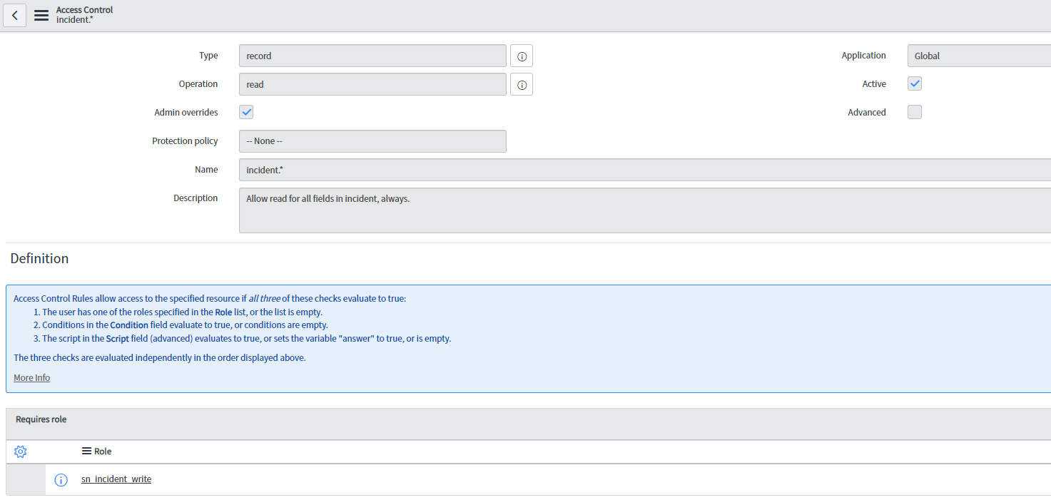

This would point to a "read" ACL issue with the respective table.
So you'd want to review both table "read" and table.* "read" ACLs and ensure those users can access the records. Most likely, with the Rome upgrade, there may have been an additional role added or the condition changed to not allow them to see it.
01-24-2022 04:42 AM
01-24-2022 06:44 AM
So it appears that users would be able to read the table itself if they are the opened_by user, the caller_id user, or on the watch list.
This is why the records are "showing" in their widget...however...they DO NOT have read permission to the fields on the table due to the sn_incident_write role being listed within that table.* ACL.
So you would want to double-check the table again, for any additional table.* "read" ACLs and see if an adjustment should be made. I don't think this ACL table.* is out of box due to it being a "read" ACL and the role specific is "write". This may have been a custom ACL someone created, but this is why you're having an issue.
Consider deactivating this ACL or creating another table.* "read" ACL and use the conditions/script to ensure those other users can read as appropriate.
