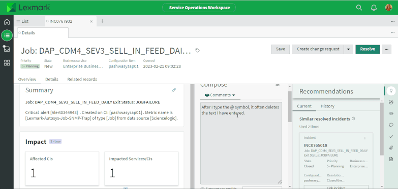

We are implementing Service Operations Workspace in Tokyo Patch 5. I am using the Chrome browser. We are seeing some issues with @ mentioning in comments/worknotes. Whenever I attempt to @ mention someone, it sometimes works and sometimes doesn't.
- After I type the @ symbol, it often deletes the text I have entered.
- If I press the Space bar, it deleted the text that was entered prior to the Space bar.
- If I type slowly (which is normal speed for most people), it drops characters from the beginning of the user's name.
See animation for examples.
This is not going to be an efficient workspace without the ability to reliably and consistently use @ mention.
Has anyone else experienced this? We will submit a support case but I first wanted to see if any other ServiceNow customers have seen this and whether you have a fix or suggestions. Thanks.

I submitted a support case and got this reply:
The issue that you are seeing is related to a known issue on the platform in workspaces.
The PRB is PRB1635028. This has been fixed in Tokyo Patch 7 which will be out soon.
