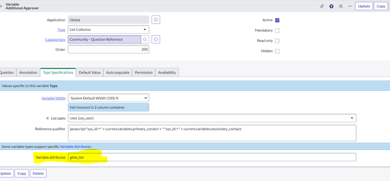

Please someone can help me to hide the list of my different choices in the List Collector variable out of the RITM if possible
The illustration is below

Hello @Jeff W NZAO B
for that List collector variable put variable attribute as glide_list

Hi @Jeff W NZAO B ,
To hide information which is available below the list collector please refer below article.
https://support.servicenow.com/kb?id=kb_article_view&sysparm_article=KB0780875
The resolution is to define a 'sys_ref_list' for that table. This can be done by following these steps:
- Navigate to https://instancename.service-now.com/affected_table_list.do?sysparm_view=sys_ref_list
- Use the List Controls to select Configure > List Layout and select the desired fields, then save.
That is all it takes to define/customize the 'sys_ref_list' view. Please note this may already exist for your table; this view is used to display columns whenever a reference look-up is invoked via a reference form field.

Please try this- navigate to the list table, open related records, and remove unwanted list elements.
