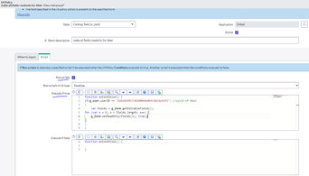

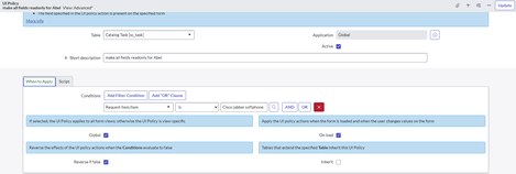

Hi @tsai25044 ,
You can achieve this functionality using client side script or server side(ACL) script.
You can create UI Policy on "sc_task" table, configure the condition as per your requirement and write the script in "Execute if true" script block.
Script:
function onCondition() {
if(g_user.userID == "62826bf03710200044e0bfc8bcbe5df1") //sysid of Abel
    var fields = g_form.getEditableFields();
for (var x = 0; x < fields.length; x++) {
    g_form.setReadOnly(fields[x], true);
Screenshots:
O/P:
