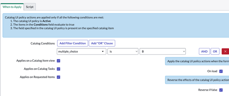

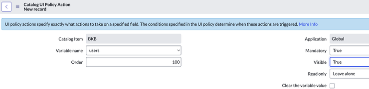

 Whatever reference post you got this from is complete garbage if this is what it said to do.  You cannot detect in a client script if a variable is visible or not.  It sounds like what you want to do in this case is remove whatever you have in place to make the second variable visible and create a Catalog UI Policy when the first variable equals the second option, with the Reverse if false box checked.  The Catalog UI Policy will then have a Catalog UI Policy Action to make the second variable visible AND mandatory.

No script is needed for this. Create a UI policy and set your conditions,
then create a UI olicy action, for the second field, this is where you can set mandatory and visible

Brad and __DC, thanks for your help!  I was initially blind to the reference to making it mandatory on that form.
