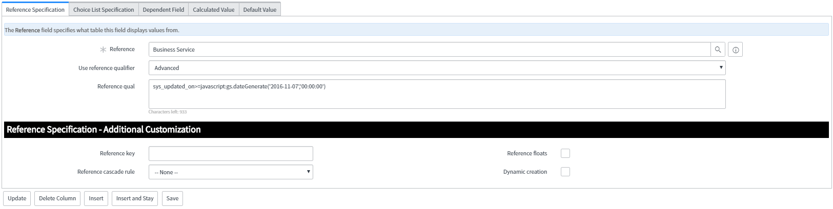

It depends on what you want to filter out exactly.  If you just want to show business services where the operational status is 'Operational', then you would add '^operational_status=1' to the end of the line you have in there already.  If you want to show all business services where the operational status is not 'Retired' you can add '^operational_status!=6' to the end of the existing line.

There's an 'Operational Status' field on the Business Service table.  Use that to mark the status of the business service.  Then set up a reference qualifier on your business service field to filter out the inactive ones.
Hi Mark,
Thank you, that's really helpful.
Please see below the fields AS IS. Could you tell me what i need to add to hide multiple business services?
Thank you again
