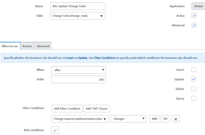

That sounds like a good solution.   So I've created a Business Rule to execute AFTER the Implementation Plan changes.
But I'm unsure of how to format the script in the Advanced tab.   Is this correct?
Simon, are the change tasks also moved back to the "draft" state?   You could accomplish this in the workflow via run script.   Might be better that way so you "compartmentalize" all the components into one place.   Where this breaks down is if these fields can be edited after the change approvals or through the lifecycle of the change which is where a business rule is the way to accomplish it.   Really up to you.
Now to address your question above with the business rule, business rules are essentially triggers as records are inserted, updated, and deleted.   They run on the record performing these actions.   So in your case the change_request record is being updated so the business rule needs to be set on that record instead and it will then update the child change_task records.   You currently have this set on the change_task which is not correct.
