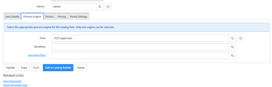

1. Give 1st action Ask for Approval and select the record to add approval and give the approver 1.
2. Next using If condition we will check if it is approved then go to the next Ask for approval action and add approver 2
3. Give created flow on Catalog Item.
refer below screenshot.

you can create a flow using flow designer and trigger condition as Service catalog.
