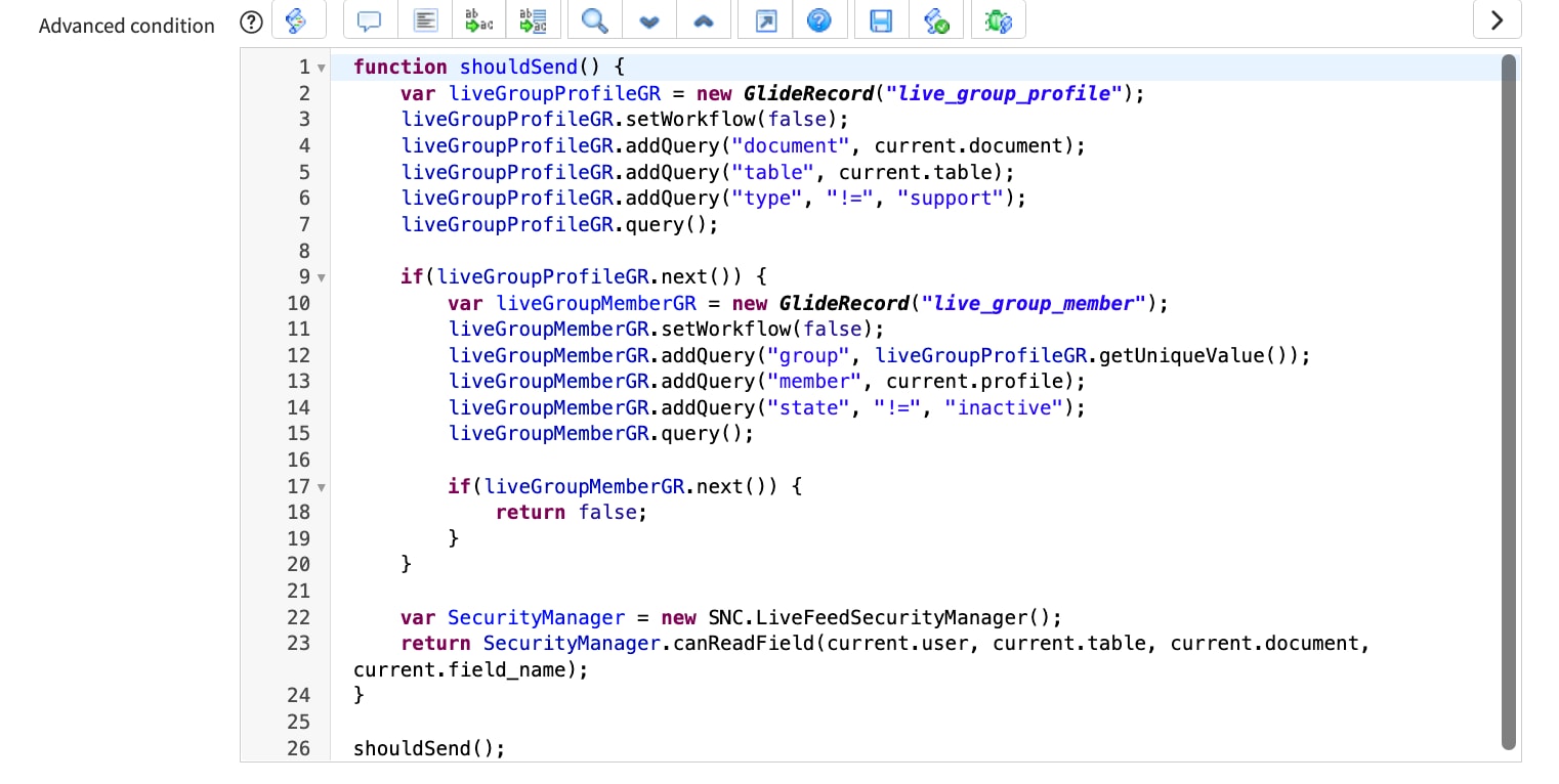

The out of box mention notification does have a condition script already in it...please verify that and see if it looks like this (line by line):
function shouldSend() {
var liveGroupProfileGR = new GlideRecord("live_group_profile");
liveGroupProfileGR.setWorkflow(false);
liveGroupProfileGR.addQuery("document", current.document);
liveGroupProfileGR.addQuery("table", current.table);
liveGroupProfileGR.addQuery("type", "!=", "support");
liveGroupProfileGR.query();
if(liveGroupProfileGR.next()) {
var liveGroupMemberGR = new GlideRecord("live_group_member");
liveGroupMemberGR.setWorkflow(false);
liveGroupMemberGR.addQuery("group", liveGroupProfileGR.getUniqueValue());
liveGroupMemberGR.addQuery("member", current.profile);
liveGroupMemberGR.addQuery("state", "!=", "inactive");
liveGroupMemberGR.query();
if(liveGroupMemberGR.next()) {
return false;
var SecurityManager = new SNC.LiveFeedSecurityManager();
return SecurityManager.canReadField(current.user, current.table, current.document, current.field_name);
shouldSend();

As for the script, here's the script on the notification, I've looked at this four or five times and didn't see a difference.
