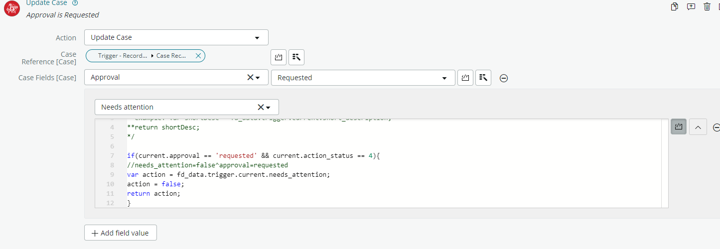

I am facing with the same issue and trying to reset the value to false with flow designer. And its not working.
This is the script used, and still it doesn't set the value to false.
So does it mean the business rule is again resetting the value to True and I am able to see the flag of Needs attention.
Is there a way that we can achieve this using flow designer without changing the BR?
