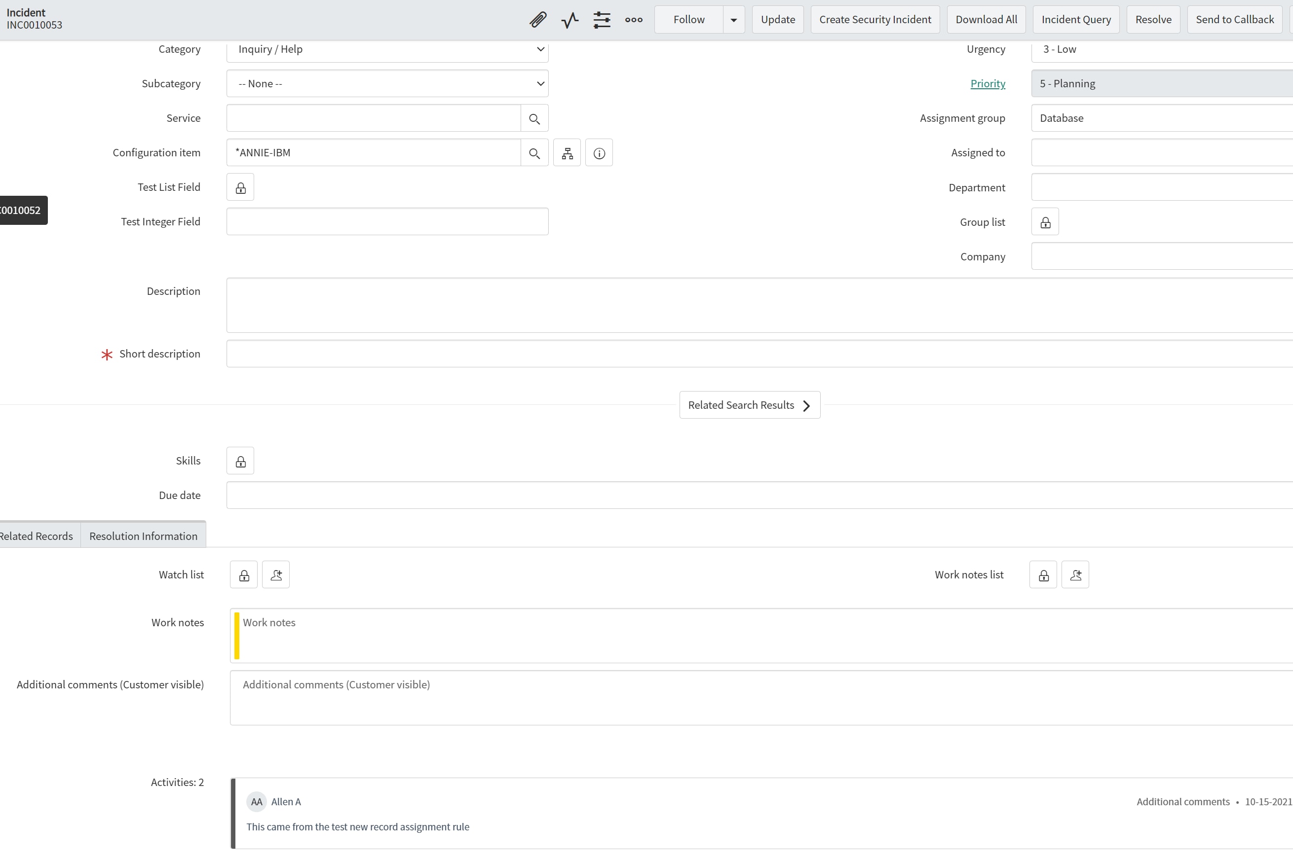

I'm sorry you're having trouble...just to confirm what I'm saying is correct. Here's a test record producer I made and it has 4 fields on it:
I created this assignment rule:
And so this is currently only set for the incident table, with no other conditions specified on the "applies to" tab:
This is the end result for the incident:
So we see Database group set and the comment is showing as I had it in the assignment rule.
For you, you'd want to verify your "Applies to" tab to ensure the table and any conditions are set properly and that the assignment rule is "active".
You'd then want to check your variable names to make sure they're right and that the values you want are correct.
The rest works as I've mentioned.
