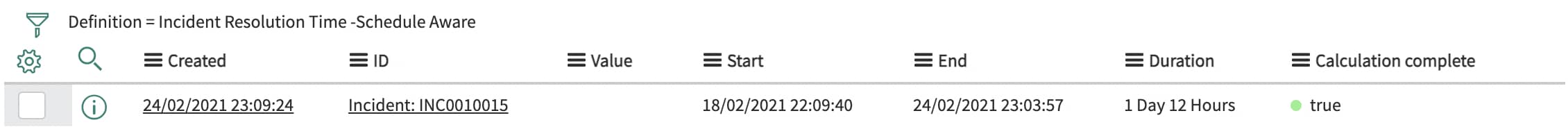

That is all we need in our Script Include, so let's see how we can use this in a Metric Definition script to calculate the duration of the resolution time against the 8-5 weekdays schedule.

Outputs a Metric Instance with the following values, remember this is only an 8-5 weekdays schedule, you may want to create a 24 hour weekdays schedule. Notice how the duration is only 1 day and 12 hours but there is a 6 day gap between the start and end, this means our work has been successful.
