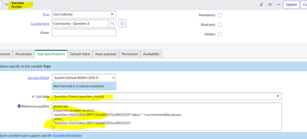

Step 1  : Create Catalog Item Variable
Type : List Collector
List Table : Question Choice
Reference Qualifier :
javascript&colon;
if (current.variables.access) {
        /* If any value selected in List collector then don't show other values*/
       "question=2eb25ddac3897110ab85241ce0013134^value=" + current.variables.access;
} else {
      * If List collector is empty or removed selected value from list then show all values*/
       "question=2eb25ddac3897110ab85241ce0013134";  // sys_id of "Access" variable

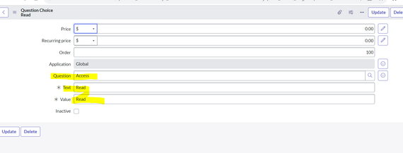

Step 2 : Create 3 question choices in Question choice table as per scrrenshot
1.Read
2.Write
3.execute

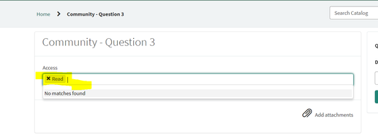

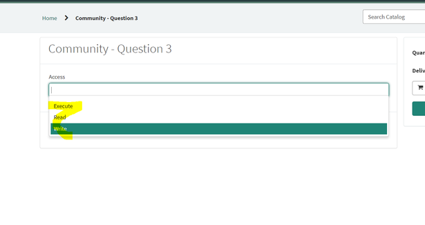

Test case 1 : List collector is empty i.e no value selected then show all Read,write,execute

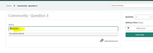

Test case 2 : If you select "Read" then "Write" and "Execute" will not display
Same for other
