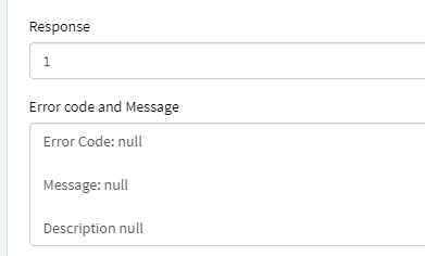

Catalog Item screen shot after I click submit ( I can see Response and Error code been set):
RITM screen shot:

Most likely this is because you're calling a script include in an onSubmit client script which is usually never a good idea and leads to issues that are similar to this.
Are you able to address this through another method, such as in the catalog item workflow? Or in a Business Rule, instead? Or even in an onChange client script.
For testing, you can change this to an onChange client script, just to test and see and you'll most likely see that it works, it'll set the values on catalog form, submit, and see it populated on the RITM variable, etc.
What's happening here is that you're submitting the form at the same time this SI is retrieving information, by the time it comes back, the form has already saved and moved on.
SI are async, onSubmits are not, so it's not timing up.

Allen, thanks for the response
yes other method works, I already tried them (thru workflow) but i wanted it to setvalues onSubmit.
I guess i will have to change it back.
