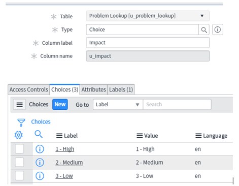

Custom Priority lookup rules for Problem Table on Istanbul did not work despite multiple attempts .
I want to set Priority level similar to how Incident Table data look up rule is set
The OOB in Jakarta has the set below.
I don't understand how Choice field is set to Category and still works out of box but not when I custom my own.
when I try to copy this setup for Istanbul instance, I get the choice list under categories which is not what I want
I tried to add my own list on custom data lookup table. That did not work either

Hi Phil,
My Istanbul instance does not have data lookup priority for Problem Table
I am trying to create something similar to what I have seen in Jarkata instance.
I have the link from product documentation but its not helping.
I know I am missing something with configuring dictionary on the fields Impact, Urgency, and Priority-
SN now has these choices pointing to Problem Table and Category Field- that does not make sense because if I configure mine the same way, it doesn't work.
