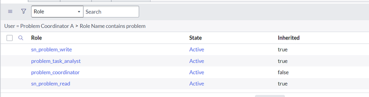

@GRajuK  Can you if problem coordinator has below roles
