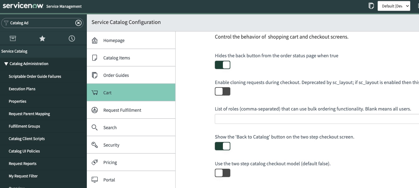

As far as the checkout page, I believe that is configured at the catalog properties level (you see that for all requests that are submitted currently, correct?) and would have to be enabled / disabled in the properties. You can verify this by going to Catalog Administration > Properties and then clicking on Cart and checking whether Use Two Step Checkout Model is active (in my screenshot it is turned off).
Changing that would change the behavior for all requests.
Unfortunately it is not configurable per item as far as I'm aware and would require some customization to the cart widget to accomplish otherwise.

On each individual item you should be able to select options for Hide Quantity and Hide Delivery Time - they're not always on the form view, I usually just add them to the list view and set them to true that way.
