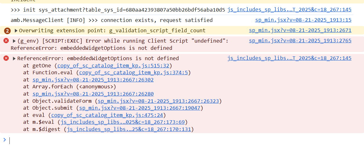

While submitting a new record in service portal , the error message is displaying "There is javascript error in your browser console"
Attached screenshots for your reference.
Please assist ASAP.

We have checked all the catalog client scripts and client scripts but we haven't find any scripts regarding the reference error, attached the same.
Is there any alternate way to check the exact script that we can check.

The error message "There is a JavaScript error in your browser console" and the attached console logs indicate a ReferenceError: embeddedWidgetOptions is not defined. This suggests that the JavaScript code is trying to access a variable or object (embeddedWidgetOptions) that hasn't been defined or initialized, likely within a client script or widget on the service portal.
From the logs, the issue occurs during the execution of a client script (g_validation_script_field_count), and the error is triggered at a point where embeddedWidgetOptions is expected but missing. This could be due to:
A missing or incorrect initialization of the embeddedWidgetOptions object in the script.
A dependency or variable not being loaded properly before the script runs.
An issue with the widget or catalog item configuration on the service portal.
To resolve this:
Check the client script associated with the "Carrier Request" form or widget for any references to embeddedWidgetOptions.
Ensure that embeddedWidgetOptions is properly defined and initialized before it is used (e.g., as a global variable or passed to the script).
Verify that all required scripts and dependencies are included and loaded correctly in the service portal.
Inspect the widget or catalog item (sc_catalog_item_kp.js:515:32) mentioned in the stack trace to ensure it aligns with the form's configuration.
