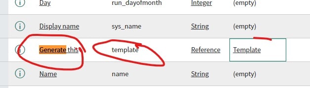

I am trying to create a record producer to give the ability to create a template and schedule a job based on that template all in one step. I am able to create the template. And I am able to create the scheduled job. But, I can't seem to fill the reference field in the scheduled job that links the two. The column name is template and the label is 'Generate This'.
I've been modifying and modifying this script in background to see if I can set the template on the scheduled job...so far no luck.

As far as I can tell, OOB table sysauto has no field named template (or labelled Template). Are you sure your instance sports such a field on that table?

after looking at it again with FRESH eyes... you are 100% correct. I feel dumb!
The actual table is: sysauto_template
