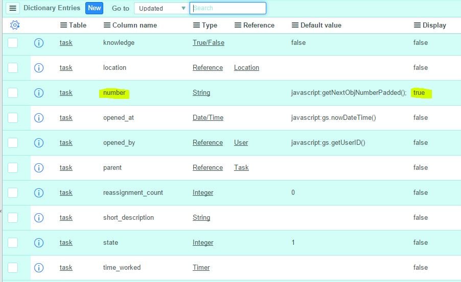

You can change the display value of any table, by going to the dictionary of that table and seeing all its fields, and setting the Display to true of the field you want, and make sure everything else is false. For example, most task table display values are the number field, so you will likely see that field Display set to true. For this CMDB table that has the Server Name field, you would set Display for that dictionary to true, and make sure the other one is turned off. This will take affect in all places/fields where this table is referenced, so make sure you know the consequences of that before you make this change.
