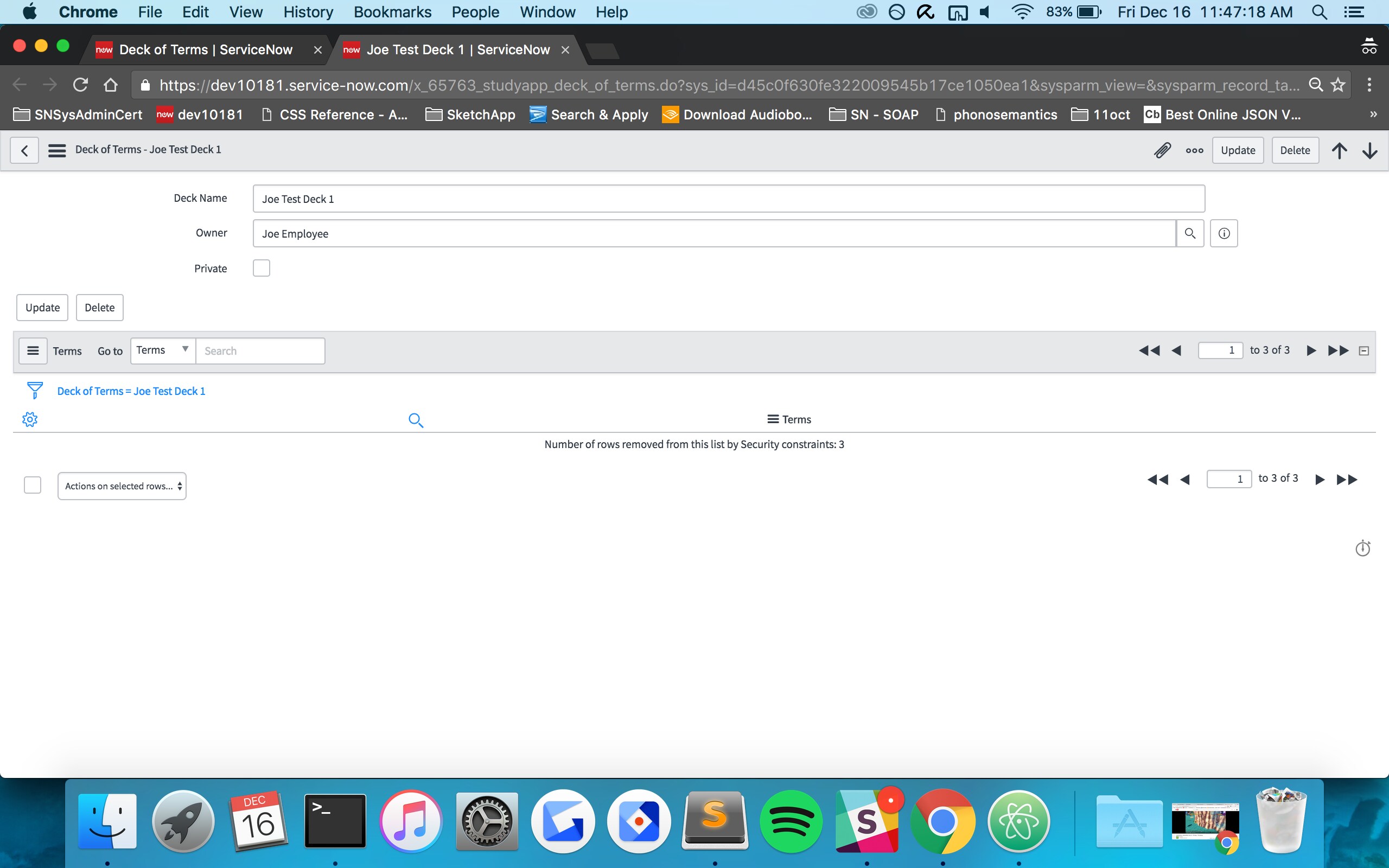

Furthermore, when I actually click on Joe's deck, the Related List of terms is blank. Instead of terms, I see "Number of rows removed from this list by Security constraints: 3" (Joe's deck has 3 cards in it, so 100% of cards are being blocked). Here's another screenshot:

1) I removed the ".*" from the ACL name definition. Apparently the ".*" indicates that the ACL rule should apply to the fields of the record in question, and not to the record itself. At this point, all the records appear on [deck_of_terms.list], but the terms are blocked when I click into any record. So it's better, but not yet fully fixed.
2) I disabled the default ACL-Read rule on this table, because (for whatever reason) the system would evaluate the default rule and then refuse to evaluate any rules after that. This is bad, because I want it to evaluate my custom ACL rule, which has the `Owner is(dynamic) Me` condition.
3) I had to create yet another ACL rule on the table [m2m_deck_to_terms.read], where I sort-of repeat the previous condition. The (modified) condition here is `deck_of_terms.owner is(dynamic) Me`. This step is necessary because the records that I'm restricting are not just on the table [deck_of_terms]; I am also restricting the records on [m2m_deck_to_terms].
